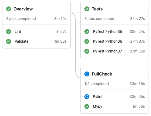

Contributions to Home Assistant are tested against our test suite, code style and typing, to make sure that the contribution does not break things. We have split our test suite into 3 different stages. By using stages, we can run a quick validation stage and fail fast if it’s not correct.
This strategy allows us to not waste any of our workers time on running a full test suite if we know that basic linting is not going to pass.
Below is a screenshot of our CI pipeline for Home Assistant. Because all work is distributed over multiple workers, the total runtime is the longest task in the first column, plus the longest task in the second column.

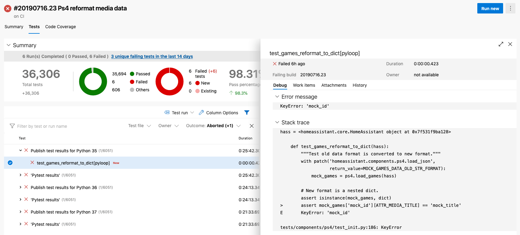

Screenshot of the test results.

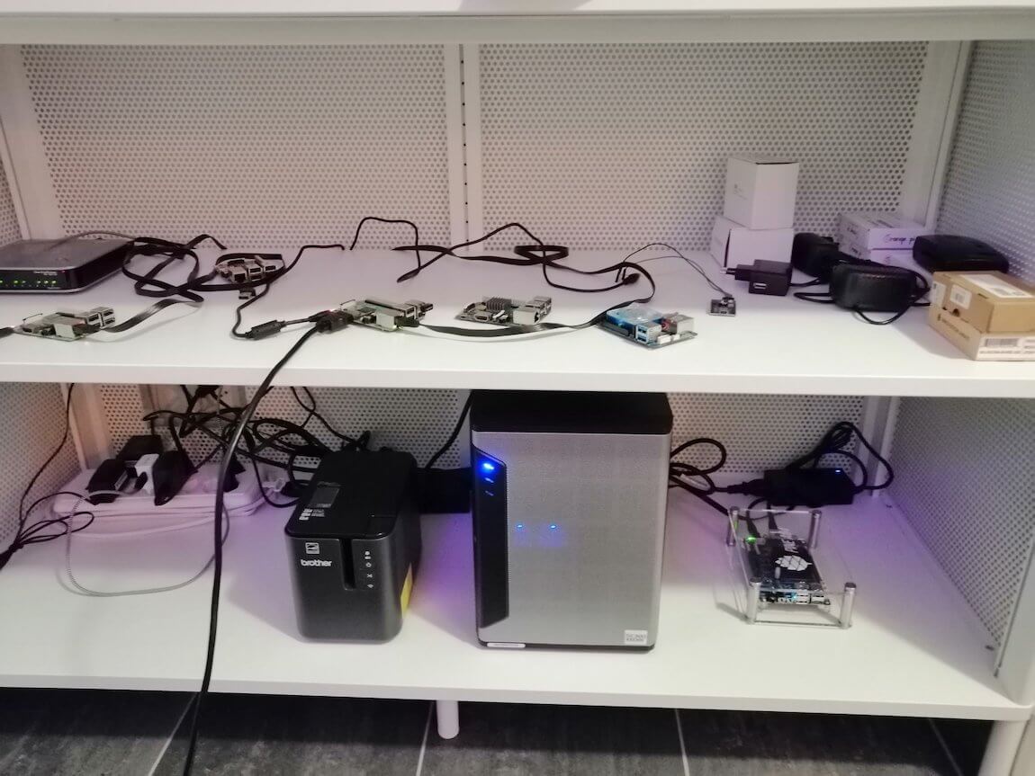

The Azure Pipelines agents are using the amd64 CPU architecture. It is possible to compile for different architectures using a method called cross-compiling. We gave it a shot but realized that it is significantly slower than compiling a build using the same native CPU's as that we’re targeting.
We use a feature on Azure Pipelines called self-hosted agents to host build agents on our own hardware with the right architecture. Azure Pipelines manages the pipeline definition and the orchestration, but the execution runs blazing fast on our own hardware.
Our build cabinet.
